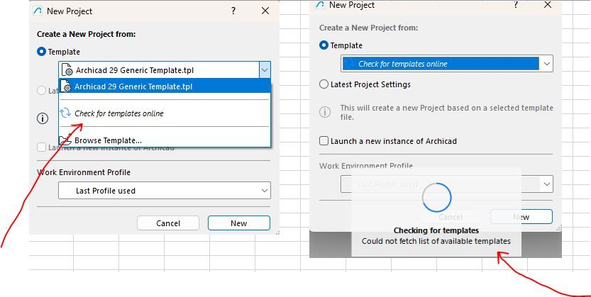

Hi everyone,
Does anyone know when the Archicad 29 USA Template will be released?
When I click “Check for Online Template” in Archicad 29, it says it cannot fetch the list of available templates, and the only option I currently see is the Generic template.
Thanks in advance!
Elshareef
Operating system used: Windows 29.02

Arch Willingham
Same here...did AC stop making the US version?

There is a known issue affecting some Windows users in Archicad 29, where localized Online Templates may not appear in the Check for Templates Online list.
For now, you can manually download the localized Online Templates from Graphisoft’s Download page:
https://www.graphisoft.com/resources-and-support/downloads?section=cross-border-cooperation&localiza...
  • For users seeking a language version other than the USA, ensure that you select the desired language from the 'Language version' drop-down.

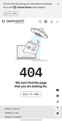

@Karl Ottenstein @Jan Millan
I’m running Archicad 29 USA (Education version) in Cambridge, MA, and I am not using a VPN.
I understand from Graphisoft’s documentation that Archicad 29 USA Templates 1 and 2 are temporary, and that the final USA template is expected to be released shortly after Library Update 1, which has already been issued. However, the updated/final Archicad 29 USA template does not seem to be available yet.
For reference, this is the article I’m following:
https://support.graphisoft.com/hc/en-us/articles/39592286990737-Archicad-29-USA-Templates
I was able to download Archicad 29 USA Template 2 and used it for my project during the past semester. However, I was not able to download Archicad 29 USA Template 1—the download button consistently returns a “page not found” error. I’ve attached a screenshot showing this issue.
That said, since both Template 1 and 2 are described as temporary, my main question is:
When is the final Archicad 29 USA template expected to be released?
