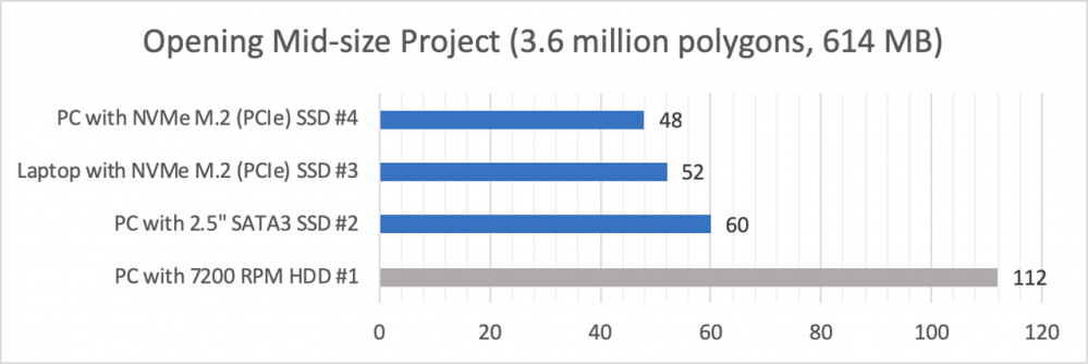

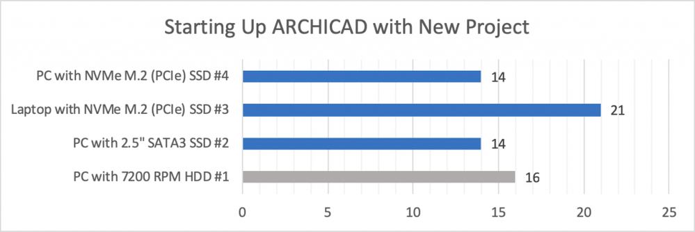

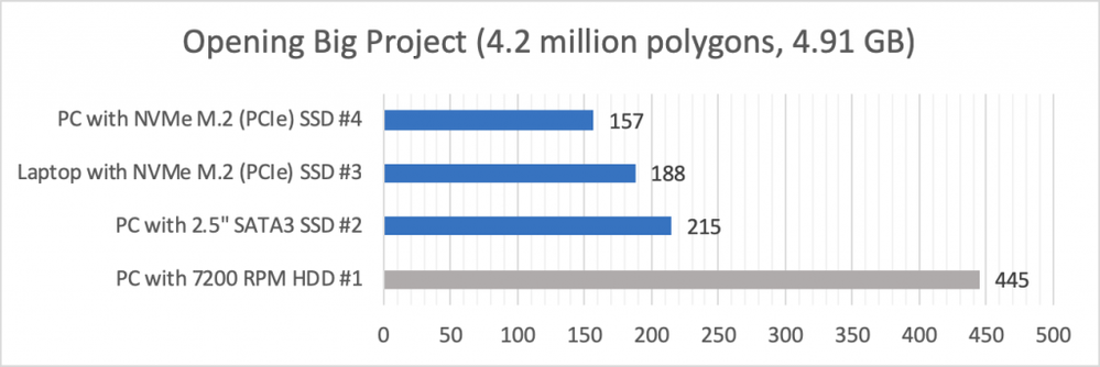

Tests on Windows PCs In desktop PCs you have all the above SSD hardware options available, but in laptops you usually only have M.2 drives available as that is the most compact (or 2.5" drives in older models). Whichever option you choose over HDDs you will experience a significant jump in speed, but the nuances between the different SSD types are harder to define, and decide whether a more expensive type is worth the investment. You can see some tests with Archicad below, that show how different hardwares stack up against each other when using Archicad. The difference is easiest to measure when opening projects, so that's what we measure. For the tests, we used the following hardware configurations:
  • configuration #1: HP Z440 workstation / Intel Xeon E5-1630v3 4x3.7 GHz / 32 GB (2400 MHz) / Samsung HD252HJ 7200 RPM (250 GB) 3.5" HDD
  • configuration #2: HP Z440 workstation / Intel Xeon E5-1630v3 4x3.7 GHz / 32 GB (2400 MHz) / Samsung 850 EVO SSD (500 GB) 540/520 MB/s*
  • configuration #3: HP ZBook Studio G4 / Intel Core i7-7820HQ 4x2.9 GHz / 32 GB (2400 MHz) / Toshiba THNSF5512GPUK NVMe PCIe SSD (512 GB) 1500/980 MB/s*
  • configuration #4: HP Z240 workstation / Intel Core i7-7700 4x3.6 GHz / 64 GB (2400 MHz) / Samsung MZVLW512HMJP NVMe PCIe SSD (512 GB) 2800/1600 MB/s* *nominal sequential read/write speed
You can see the results of our tests below. The values are in seconds, the lower the better.

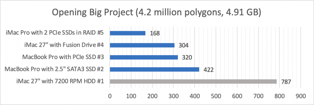

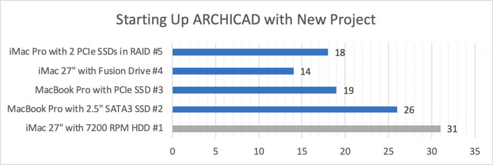

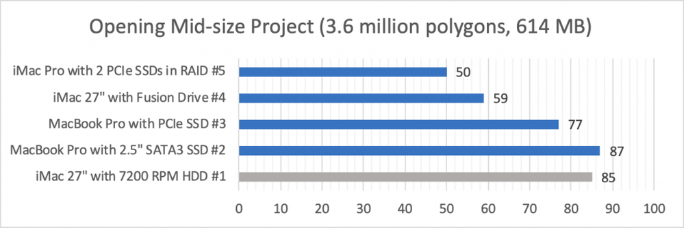

Tests on macOS computers Apple Mac computers offer less customization, so their recent line-up mostly uses M.2 drives. In older Macs (2012 and before) they were still using 2.5 HDDs, so you can replace that with an SSD, but in newer models, you can only change the storage size of the SSD, and can't change it to a different type or add an HDD - in some MacBooks, the storage is soldered on the motherboard. Apple's new APFS File System also promises faster access for SSDs, so if you haven't yet, you should update your macOS to 10.13 High Sierra or newer. You can see some tests with Archicad below, that show how different hardware stack up against each other when using Archicad. The difference is easiest to measure when opening projects, so that's what we measure. For the tests, we used the following hardware configurations:
  • configuration #1: Mid 2011 iMac 27" / Intel Core i5-2500S 4x2.7 GHz / 16 GB (1333 MHz) / WDC WD1001FALS 7200 RPM HDD
  • configuration #2: Late 2011 MacBook Pro 15" / Intel Core i7-2675QM 4x2.2 GHz / 16 GB (1333 MHz) / Samsung 850 EVO SSD (250 GB) 540/520 MB/s*
  • configuration #3: Mid 2014 MacBook Pro 15" / Intel Core i7-4870HQ 4x2.5 GHz / 16 GB (1600 MHz) / Apple PCIe based SSD module (500 GB)
  • configuration #4: Late 2015 5K iMac 27" / Intel Core i5-6500 4x3.2 GHz / 16 GB (1867 MHz) / Apple Fusion Drive (1 TB)
  • configuration #5: Late 2017 5K iMac Pro 27" / Intel Xeon W-2140B 8x3.2 GHz / 64 GB (2666 MHz) / 2 Apple PCIe based SSD modules (working as a 1TB single drive) *nominal sequential read/write speed
