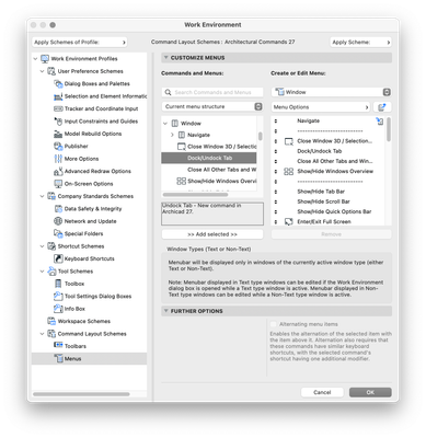

Britt:
It should be part of the standard Work Environment. You can add it to your Work Environment with the Dock/Undock Tab command.

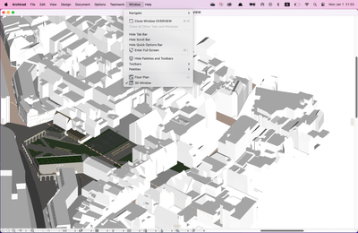

Hi David,
Thank you for your reply!
Can it be that the option Dock Window 3D is not among the options? (see image)
I can not find it 😅.
Kind regards,
Britt

Solution
Britt:

It worked. Thank you so much!
Kind regards
