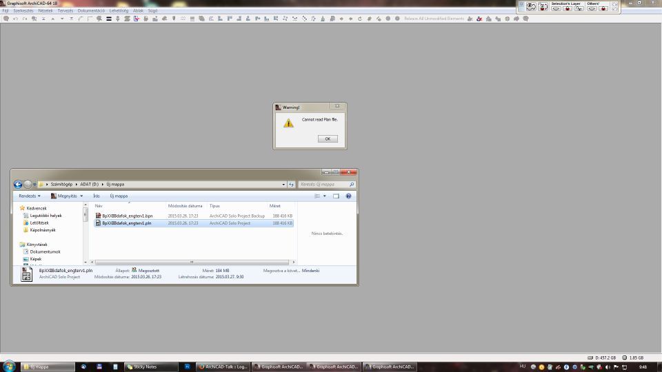

Hibaüzenet nélkül elmentettem egy fájlt. Másnap nem tudom megnyitni. Se a pln, se a bpn formátumút. Másik gépen, másik mappában sem. Hogyan tudnék hozzáférni egy heti munkámhoz, ami így bentragadt a fájlban, legalább részlegesen?
I saved a file, normaly, with no error message. Next day I cannot open it. Neither pln, nor bpn. Neither tried on other maschine, nor from other folder. How could I get acces to my work, that closed to this broken file? At least partially?

I tried to open the .bpn file too. This is the back-up?
There is an AutoSave Folder in my maschine, but in this folder and subfolders there are no files wich could I associate to ArchiCAD, or any other application, so it isn't seems could solv my problem.
