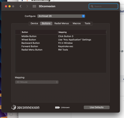

So. My dialog box doesnʻt look exactly the same as I have the Cadmouse wireless. However, I think Im getting closer to what I need, I am just not sure how to configure the wheel button to orbit my 3d object....

a screenshot would help explain your issue.

Paa
 Whatcha think?
