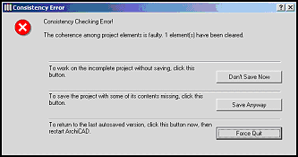

I had a user get this error recently. The screen-shot below is pretty bad, but you can get the general idea of what it looked like. It was a "Consistency Checking Error" and it gave him options to continue without saving, to save with some of the contents missing, or to return to the last autosaved version.
What triggers this? He says he was just adjusting a section marker. Any info is greatly appreciated!

you must mean one of these! haven't seen it since 8.0.0 and today it reared its ugly head once again.

This is because Permanent Integrity Checking is on in Preferences>Data Safety.
This is Graphisoft's explanation:
"...Activate the Permanent Integrity Checking checkbox to continuously check the integrity of the data in your Project (not just on opening and saving files). Should any of the data in your file be corrupted, ArchiCAD will immediately try to repair it and inform you of the result..."
What 'corrupted' entails, I would like to know!:-)

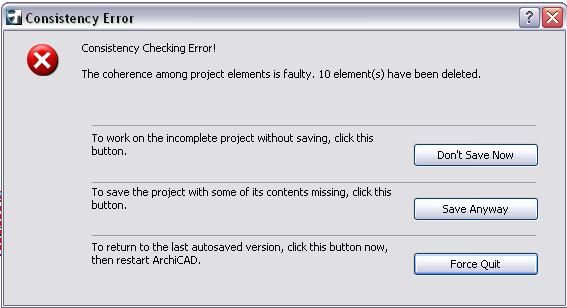

I got this today on ArchiCAD 10 - deadline coming up... can't fiddle with the problem now.
A colleague tells me she had this on a huge teamworked project a couple of years ago, and it turns out the entire .plp was corrupted.
I have never had this - but I've always worked on my own license instead of a networked office license as I'm doing now. I've also never used polylines and hardly used detail windows - all of which I'm doing in this little project which is not teamworked, unlike the colleague's.
She told me horrors of having to copy parts of a very old version of that project into a new PLP and redo all the lost work since the old version... please, no!!! I'm starting to worry as it was "1 deleted element" last week, then no more problem, and now "10 deleted elements" today! I hope this does not work exponentially...

If possible, I would merge the file into a template ... or the other way around.
Some refreshing is definitely needed!
Is it teamworked or not?
