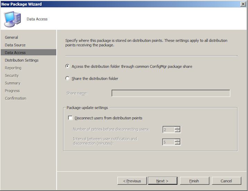

Set the Data Access tab according to the next screencapture:

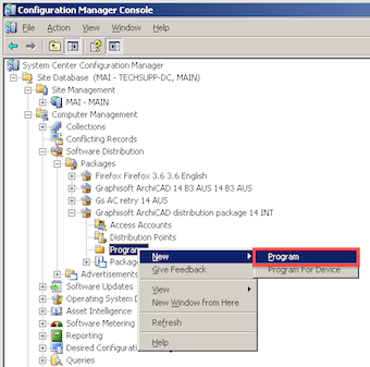

Create a Program for the Package

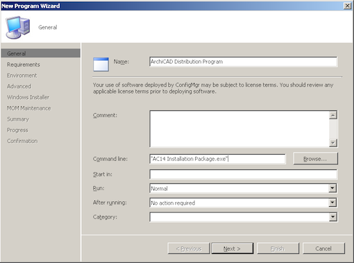

In Configuration Manager console, expand the newly added package and right click on Program, choose New / Program from the list of options:
In the appearing dialog set the fields according to the screen-capture:

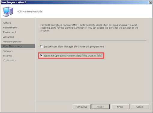

On the MOM Maintenance tab check-in the "Generate Operations Manager alert if this program fails" checkbox:
wp-content_uploads_archicadwiki_deployinginstallationpackage--newprogram_mommaintenance.png

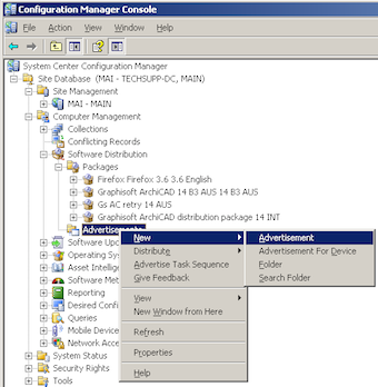

Create the Package Advertisement
Click on Site Database/Computer Management/Software Distribution / Advertisement right click on Advertisements and choose New Advertisement.
wp-content_uploads_archicadwiki_deployinginstallationpackage--advertisementnewclick.png

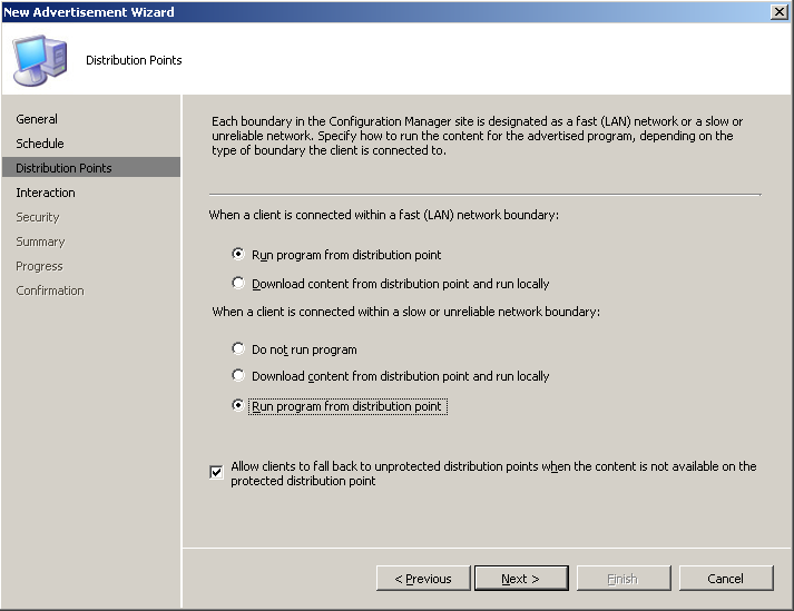

Set the Distribution Points tab as you prefer.In the screen-capture you can see a setting where the program is run from the distribution point (the server), but you can also choose the program to be downloaded and run locally.

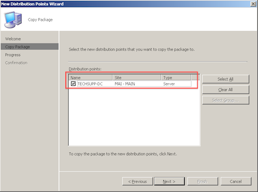

Create Distribution point
In Configuration Manager Console click on Site Database/Computer Management/Software Distribution/Packages, expand the package we've already created go to the Distribution Points, right click on it and choose New Distribution Point.
There is only one tab to fill in this dialog, the Copy Package one. You only need to check-in the check box:
wp-content_uploads_archicadwiki_deployinginstallationpackage--newdistrpoint_copypackage.png

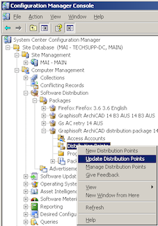

Update Distribution point
In Configuration Manager Console click on Site Database/Computer Management/Software Distribution/Packages, expand the package we've already created go to the Distribution Points, right click on it and choose Update Distribution Point:
On the appearing dialog click Yes.

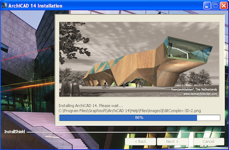

The installation itself
After clicking "Yes" it depends on the client computer to check on the server if there are new packages to install. When this happens a message will appear in the tray of the client computer notifying of the existence of the package. At this point the person in front of that computer can manually trigger start the installation, otherwise the installation will anyway start after the time set up .. expires. For testing purposes on the client computer you can force the Configuration Manager to check the existence of the package immediately thus you don't have to wait for the client to do this by itself. For this you have to go into the Control Panel / Configuration Manager. There you have to go to the tab called Actions and initiate the Machine Policy Retrieval and Evaluation Cycle and the User Policy Retrieval and Evaluation Cycle actions.
The installation at this point will be carried out in an unattended manner, nevertheless the progress bar is displayed during the installation process:
