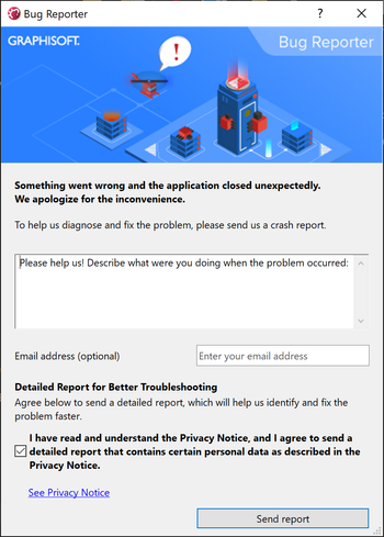

Submitting a crash report
The Bug Reporter starts automatically if Archicad crashes. Before submitting a crash report, you can change the report type, add a description, and provide an email address.
  • Detailed Report: By ticking the checkbox, you agree to send a detailed crash report. If you do not tick this box, the crash report will exclude user identification. Detailed crash reports help us identify and resolve issues more quickly.
  • Description: You can provide additional details about what led to the crash to help us better understand the issue.
  • Email address: In rare cases, we may contact you directly for more information using the provided email address. This field is disabled for anonymous crash reports (when the checkbox is not ticked).
When you click the "Send report" button, the Bug Reporter will attempt to establish an internet connection with a Graphisoft server. If the connection is successful, your report will be submitted, and you will receive a Bug ID if you chose to submit a detailed crash report. If the connection fails, you can save the report file as a .REP file on your computer and send it to your local support.
