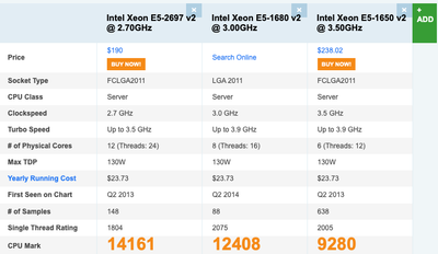

My only concern with this upgrade is that although I am doubling the number of cores in the processor, the speed is roughly 25% slower. Will that offset most of the "gains" I am getting with this upgrade? Although the cache size also more than doubles but I am not that technically savvy to evaluate the differences.

Maybe consider E5-1680v2. It's an upgrade in both ways.
Just bought one and I am preparing to upgrade that myself, though I would not recommend that to others especially ones not familiar with the machine in question. And 128GB RAM and 2TB NVMe with sinTech adapter.
