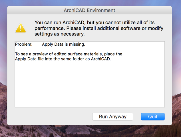

I have a student who works in the office with me, he has a normal commercial version of AC19 installed as well as AC19 Edu version. He ended up renaming the 2 apps to the above mentioned versions, but that caused an error ( see attachment ).
Is there a way that we can differentiate between the 2 icons?

Do not rename the APP, rename the folder and it should be easier to do it at install since then AC's uninstaller will know were to look.
Then read here to change the icon
http://archicad-talk.graphisoft.com/viewtopic.php?t=23403&postdays=0&postorder=asc&highlight=app+ico...

Thanks very much for the info
