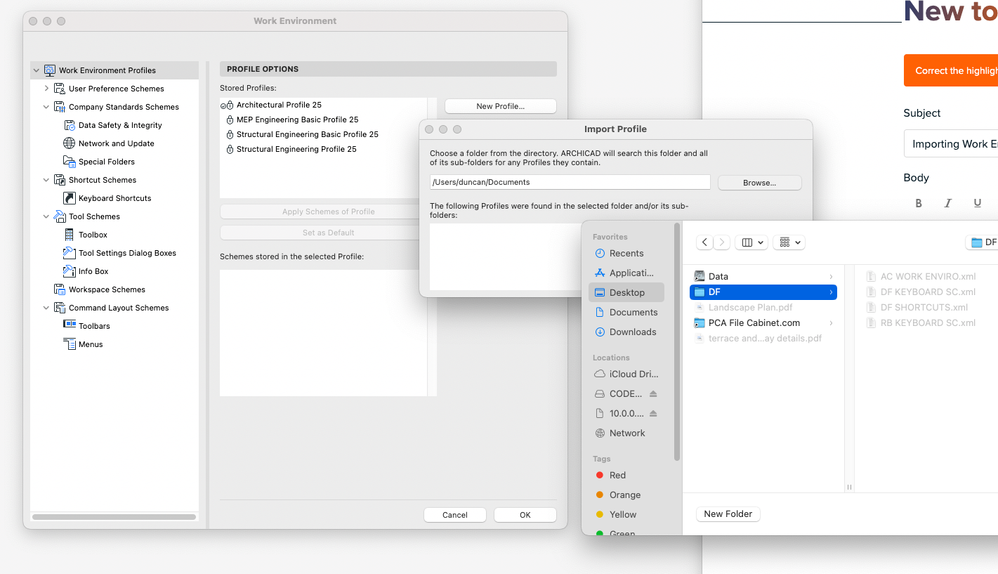

Trying to import a Work Environment Profile and or a shortcut scheme and the .xml files show up grey and are inaccessible. Any idea of why this might be?
Thanks!

I think when importing a scheme into your Work Environment, you want to browse to the level of the folder that the .xml resides in. Pick that. Then in the next dialog back in Archicad, you'll select the scheme to import.
