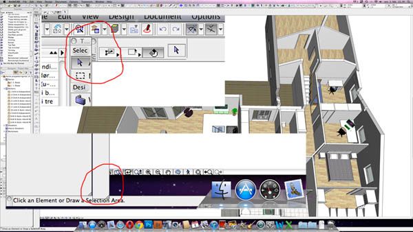

ArchiCad was very easy to work with on PC. Everything was where it was ment to be.
On this Mac on the other hand, I think everything is a big mess. All the independent windows, the palettes and the toolbars don't really snap to anything. I have to customize all the time to make things fit pretty good together. Moving things back and forth, but nothing really fits! Corners doesn't mach up...
This was never a problem on my PC (Yes, I miss my old computer...)
And the doc at the bottom suddenly appears from time to time even though I've told it not to in the system preferences.
When it decides to do so, it pushes the window (drawing) I'm working on up, but not the palettes! So it just looks horrible.
It's easy to loose the top of the window I'm working on. I've accidentally moved it too high and cannot reach the top bar to move it back.
Was buying a Mac a misstake or am I just having problems converting to Mac?
