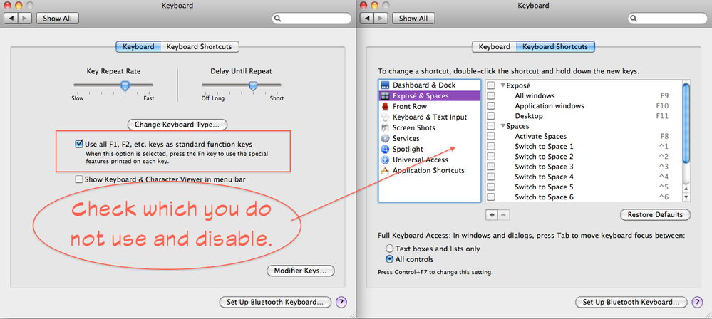

Rod Jurich
Ralph wrote:
/... To use the function keys for F1-F12, hold down the fn key too.
Or, see attached regarding the Function keys. I also disable many default shortcuts so
that there isn't any conflict with keys set in ArchiCAD.
Look under the icon in your menu for System Preferences.
