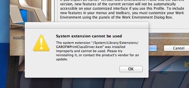

I got this message after installing 16. What is it and what does it mean?

Weird. My /System/Library/Extensions does not have anything like this GAROFPrintClassDriver.kext ... and I cannot find anything similar via Google...
Wonder if you got a (gasp) Mac virus of some kind... Did you try deleting the kext - if it is in fact in your /System/Library/Extensions folder - and rebooting?
Looks like some Canon printer driver bsed on a search on Google:
https://www.google.com/search?q=GAROFWPrintClassDriver#hl=hu&sa=X&ei=BjP8T7KmJ4zVsgb46_XFBQ&ved=0CDw...
Maybe you could try to reinstall it.
I have successfully installed 16 on one of my machines, the other (after 2 attempts) still won't restart properly. Any idea as to which system files are changed during installation? I think that is where the problem is occurring.

kext files in the Extensions directory are typically device driver software. This is almost certainly a printer driver as Laszlo suggested. I avoid most software bundled with printers these days because they are typically poorly written and problems like these are not uncommon. The Mac OS has a vast range of drivers at its disposal, so adding other drivers is often unnecessary.
BTW - there are no genuine viruses on the Mac OS yet. Trojans, yes, there are a few. A real virus would be big news.

By not allowing the install to change any of the system files (clicking cancel when it asked for my password) I got the program installed and it seems to be working fine. Not sure exactly what didn't get installed though.
