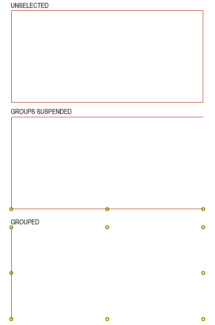

The above card does not appear in the Video Card database. We are experiencing some strange selection bugs (see attached image) on both of our 2 new MacPro workstations with these cards (see sig for full system info). The problem occurs with any non-black pens, is not limited to grouped elements and is not file specific. However it does not occur on the new machines with a New>Use Default Project Settings file. As it does not occur with existing files on the old G5's, so I am starting to think there is something in the office template which these new video cards do not like.
Has anyone had an problems with these cards?
I hope to be moving us over to 10 shortly and so a new template from scratch may solve the problem but only for those projects in the early stages.

OK i just ran most of the tests in the AC9 test file with no problems, and the problem shown above in 9 does not occur when i open the file in AC10 1010INT.
I guess this discussion should move over to the other thread then
PS. Ben my first impression of AC10 on this spec MacPro is it smokes! No obvious problems but i will keep you posted as i get into a real project with it.

I only had a few days to play around with AC10 AUS before the holidays but i did not experience any problems with the 7300GT - with our v9 files, a new V10 file and the v9 graphics card test file. So to me it looks like a problem with AC9 and the MacPro w/ 7300GT.
I have not had any experience with the x1900 but my understanding is the graphics card will make little difference for AC ... RAM on the other hand makes a big difference so i would definately go with 4Gb rather than 2Gb. We have 5Gb on all our new machines and you really do notice it when you are running multiple apps (like 2 copies of AC)
