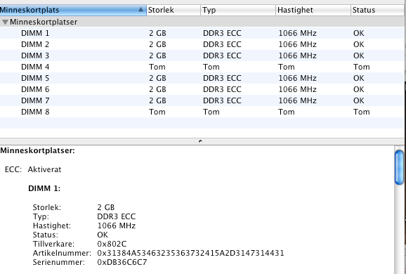

Got one dual 2.26. Very nice machine. As Owen says, get 6 identical 2GB memory DIMMs and install 3 in each bank as pic shows ("Tom" in Swedish means "empty" 😉 . This seems to be the fastest combination. Read ArsTechnica's review for more info. (We ordered the machine at a local dealer who uses quality third-party memory chips, with warranty 'n all).
You don't need 12 GB for Archicad (yet) though. But it's very nice to have if you wanna run several instances of it, or Artlantis etc in parallell.
AC13 uses all 16 virtual cores for updating views, 3D and drawings, and is very fast. ArtlantisR2 also uses all 16 cores, and I guess Artl3 too.
