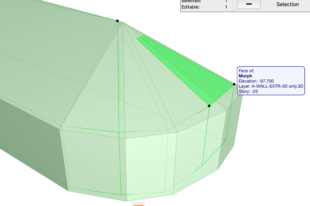

Some weirdness going on in the way my faces and edges are highlighting. Is there anything I can do to avoid that?

Yeah, noticed similar things happening here too, even in Plan view (pre-selection of slab in screen shot below but also happens with fills and other elements). Also AC19

Based on the attached screen photos, the reason of both issues is likely to be the Far From Origin phenomenon:
http://helpcenter.graphisoft.com/troubleshooting/3d-modeling/far-from-origin/
Please follow the description of the Help Center article to fix the issue! best, k
