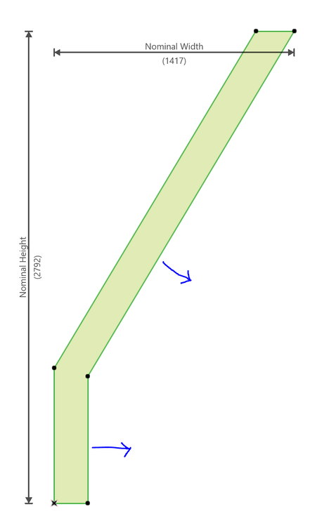

When offsetting edges you can either offset one of all, I can't find a way to offset a few edges from a selection. There's no way to actually select an edge. I am attempting this in the Profile Manager:
Such a simple operation should be obvious to perform. I am new to Archicad (coming from poly modeling applications mostly) and I am shocked at how difficult and non-intuitive it is to perform basic geometric operations. 😬

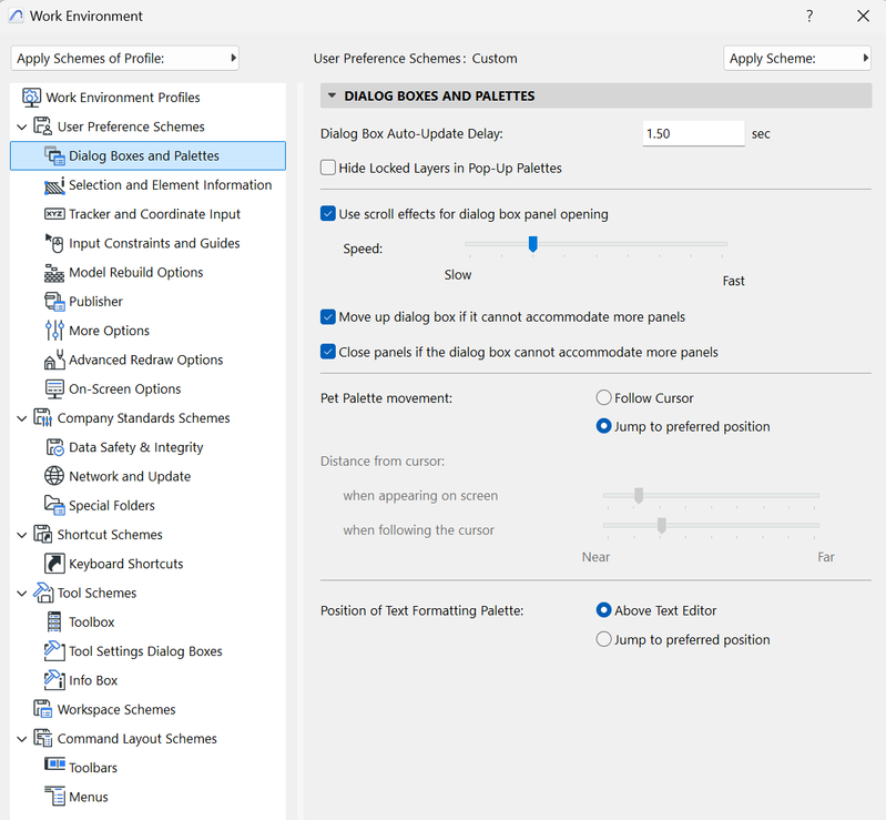

Just click on the edge and pet palette should pop up for you to choose the offset edge tool.
Anyway, you can check if pet palette is hidden somewhere. Also take a look at dialog boxes and palettes setting from Work Environment. Maybe Follow Cursor option for your Pet Palette movement could get the job done.
