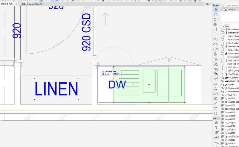

Has something changed in A27? I can not offset from a base point.
When I previously wanted something a set distance from something else, I would
  • select the item
  • CTRL D
  • Move the item along the access to the thing I want to offset it from
  • Type the distance I want it offset
  • hit the "-" (Minus) key
  • Enter

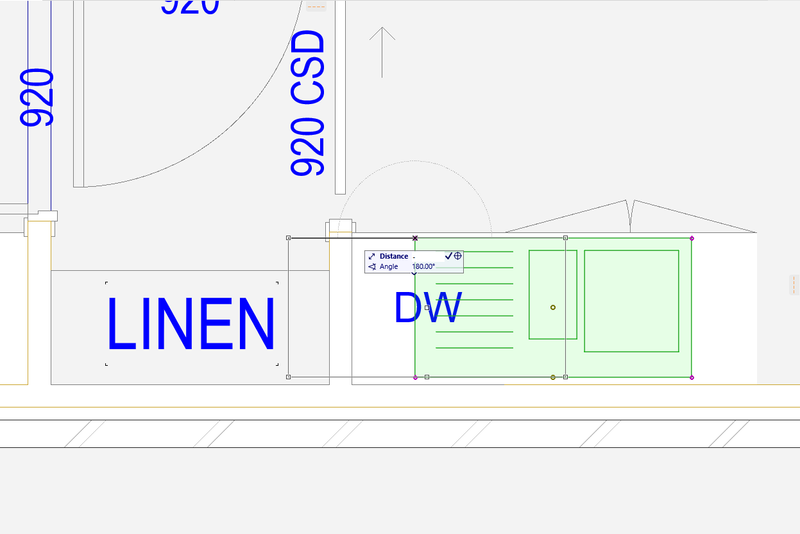

Now when I type the distance, then hit the minus key, it just clears the distance and gives me the annoying "boing" tone that can not be turned off anymore.
Any ideas on what I am missing?

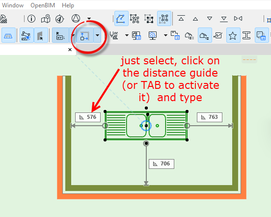

Also in 27, and ideal for this sort of thing is the new (experimental) distance guides.
Turn them on in the Work Environment > More Options > Experimental section.
Make sure you have the distance guide tool in a tool bar.

Hi Barry, as always great to hear from you.
This distance guide is a great feature, thanks for sharing that.
