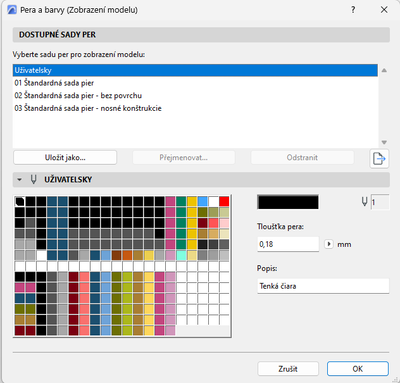

Hello, i have the same problem with pen settings. In the pen set options it looks normal but once I go to view map it change pen set to diagonal format. Can you explain more about the solution you wrote? Because i did not understand what you actually did to solve this. Thank you much.
They look like 2 completely different pen sets.
make sure you are not using a 'Custom' pen set.
Hey, every pen set is doing the same thing, custom or the saved one it doesnt matter. I tried uninstall and install archicad but nothing changed. Every pen set is displayed like this, in diagonal order.
Hmm, it seems you pens set has only 12 rows when you choose to select a pen.
There should be 13 as in your pen setting dialogue.
I would be contacting your local Archicad support people.
