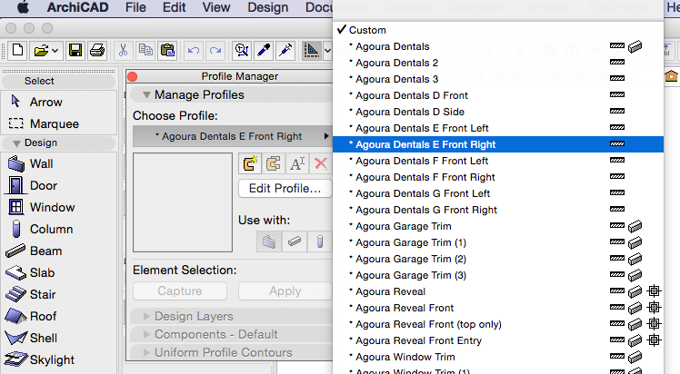

Greetings, in AC19 the profile manager list behaves differently than in earlier versions. The list of profiles in 19 is limited to one column wide which goes off the screen such that you cannot see the graphical depiction of the profile. In earlier versions more columns were added automatically as the list of profiles increased. Also, the list is limited in the quantity of profiles to the extent that I cannot add a new profile. Please see the attached screenshot of the top of the list and advise if I am missing a setting somewhere. Thank you, Scott
UPDATE: The PLN file is somehow corrupt with respect to the listing of complex profiles. The Profile Manager works correctly in other AC19 files. I have tried New & Reset All but that does not help.
