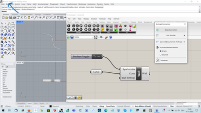

For those who can't wait I did a "quick & dirty" test. Copied the Plug In from the Rhino 7 Folder to Rhino 8 and it seems to work...Rhino8-Test.png

@Nurbs Thanks for this, I copied the ArchicadConnection.gha from the Rhino Grasshopper/Plugins folder to the corresponding one in Rhino 8, however the archicad dropdown has not appeared in the toolbar in grasshopper in Rhino 8. Am I missing a step?

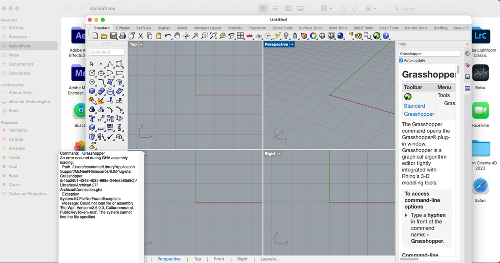

Has anyone managed to get it to work on the iMac?
Copy folder from rhino7 to rhino 8 and it keeps showing an error and doesn't load the archicad menu. Loaded all other plugins
