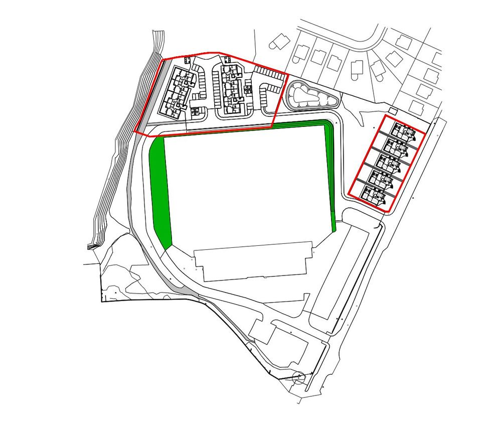

I am experiencing problems when using renovation filters with certain hatch types.
On screen everything looks fine but when i save out/Export or print/plot a particular hatch pattern 'Symbol Fills' 'Gravel' shows up as normal, NOT overidden as the filter settings.
In my case i want it to be clear white with no hatch pattern for a key site plan but i saves out with everything else correct but the Gravel hatch shows as normal?
Is this a bug or am i doing something incorrect.
Note: if i reduce the spacing of this fill type it no longer shows up but the hatch is too small when i do want to see it!!!
Nothing in the attached image should have a hatch pattern shown, it doesn't on my screen!
