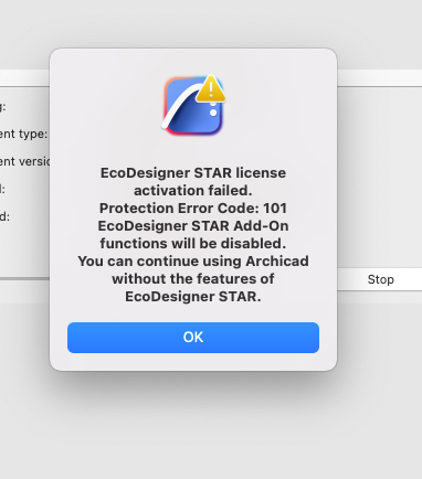

When I open ArchiCAD 26 i also get this error message pop up: Screen Shot 2023-03-29 at 9.47.09 am.png
Cheers,
Ben

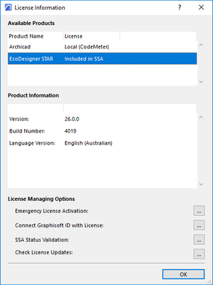

I just checked in the HELP menu and it shows I have a license.
But you do need an SSA/Forward support agreement.
If you have a support agreement then contact your local support to ask what s happening.
Without a support agreement, you will not have EcoDesigner STAR - yous standard EcoDesigner.
