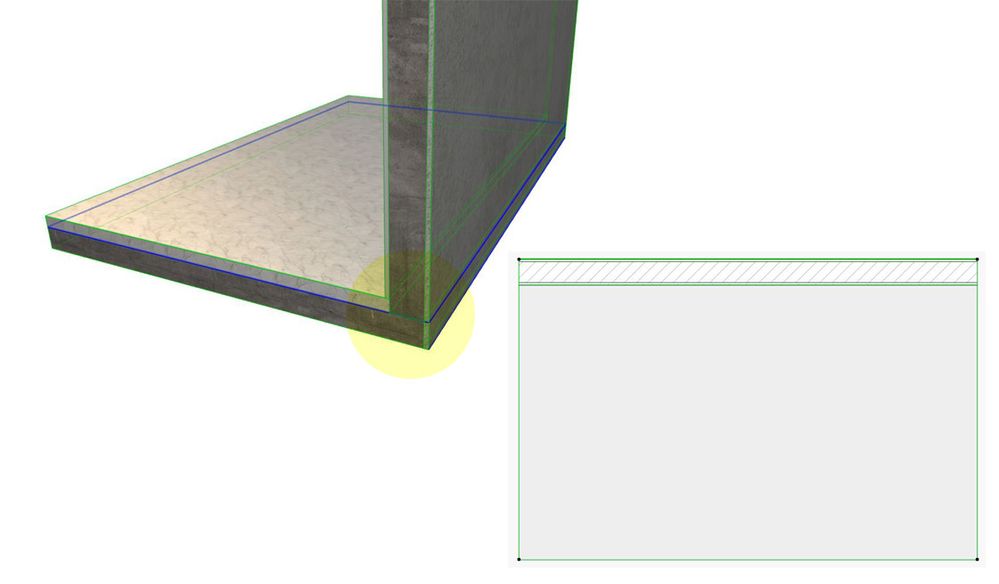

Hello everyone. Just installed Archicad 17 edu to find out that the selection dots could not show in 3d window just the element contours and the reference lines. In plans and section/elevation are shown normally. Has anyone that problem before? Any ideas to fix it?

Is it the same in OpenGL and the Internal engine?
I would try updating your video card drivers and see what happens.
Thank you for your reply. You were absolutely correct. Internal Engine worked so I updated my display drivers and dots came up as normal. It was probably an OpenGL issue. Ati mobility Radeon HD 4670 for the record.
