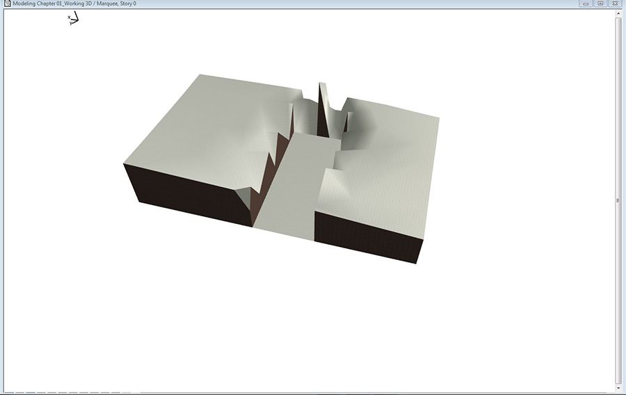

Working through step 01-04 of the advanced modelling tutorials. When I make the sloped road, the result is as per the image.
Would anyone have any idea on what step I have missed or what I have done to cause this result?

I think I have seen this before.
The Tutorial was originally done for ArchiCAD 12 or something. In that version it worked as far as I remember.
Most probably some code has changed in how ArchiCAD handles such situations so in later AC versions this problem may come up.
I think the best you can do here is to select the Mesh in 3D and move the Z height of the problematic Mesh poinst to their correct vertical height using the rightmost command in the first row of its Pet Palette.
