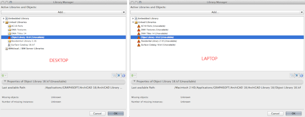

Attached is image with file paths for both machines (same OS and AC build) when libraries have been located and when they are missing (see following post). In reply to bug #171908 I was told "ArchiCAD always search libraries with the full path (to hard drive). If the path of the library begins with system volume, ''/Volumes/Macintosh HD/" is not displayed in Library Manager." Thanks for looking into this issue.
David

Second image.

It looks like this was fixed in Hotfix 5014 for AC18 (this Hotfix was pulled due to a TeamWork issue, but works for me: ArchiCAD 18 Update 5014 Suspended). I couldn't find a reference in the Release Notes.
David
