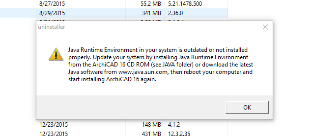

Uninstall old version error messages
Im trying to uninstall v16 and 17 and I get this error message
I dont have the disks
1 Reply 1
Here is a link that may help.
http://helpcenter.graphisoft.com/technotes/setup/software-technologies/java-versions-that-are-suppor...
There is a link there for the java installers.
You may need to remove newer versions of Java if you have them.
You can always upgrade to the latest version after installing and hot-fixing.
