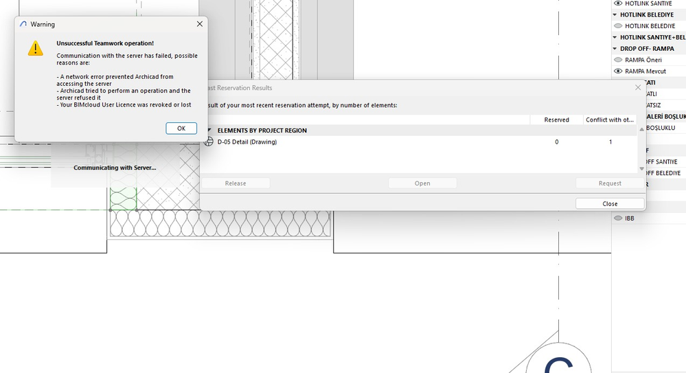

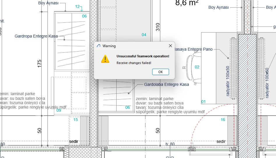

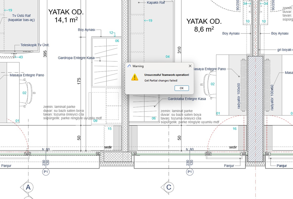

I have a teamwork project that I work on through BIMCloud Basic.
The .pln file size is 5 GB. When I share the project on BIMCloud Basic, it is 10 GB. I know this is normal.
but,
when I work on this project and send/receive files, I started getting a lot of error messages.
I've tried saving the file as .pln, applying “open and repair,” and sharing it under a different name multiple times, but it didn't solve the problem. I need to work on the file stably and deliver the project. I didn't see this issue before.
My file is from Archicad 18, and I'm currently working in version 27—could this be affecting it? Or are there other points I should be focusing on?

@Sefa Yakut,
You say that the PLN file is 5 GB. That is not normal, and it is not good.
On the BIM Manager Program, we teach that a PLN file over 1 GB is considered large, and above 2 GB it is of critical size, which may cause all sorts of problems. At that point, you need to start to seriously consider managing file sizes and bringing them down to manageable sizes. Some of the things you may consider:
  • Dividing the Project File into multiple PLN files (and hotlinking them as necessary)
  • Splitting the Project File into two PLN files, one containing the model only, and the other containing the documentation only (Layout Book).
  • If your Embedded Library is very large, exporting it, uploading it to the BIMcloud server, and linking it from there, so it does not increase the size of the Project File.
  • Checking what is causing the huge file size (large placed images/documents, point clouds, lots of attributes/textures, etc.) and taking steps to reduce it.
