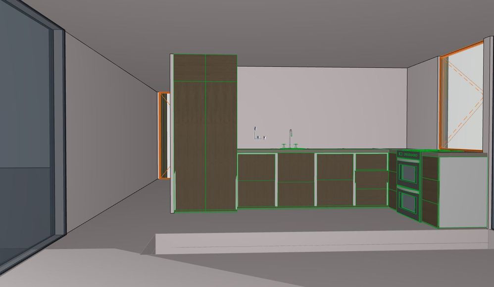

I have a problem in Archicad 18 explore mode(explore mode is the 3d option to move around in the 3D model). I made 2 print screens of the problem, it's about overlapping(don't know if is the right word for this) elements in 3D, explore mode. Basically, explore mode shows elements behind other elements.
the error part:
http://s13.postimg.org/u0buef0s7/image.jpg
how the image should look:
http://s16.postimg.org/jysw9dpk5/image.jpg
This is my PC - maybe because of the video card or bad settings.

The first thing we usually suggest in case strange results are displayed in the 3D Viewpoint is to try to update the graphics card drivers to the latest versions and see if that makes any difference. So please do that and let's see.
I would also suggest that you update to the latest ARCHICAD 18 build: http://archicad-talk.graphisoft.com/viewtopic.php?t=51770
