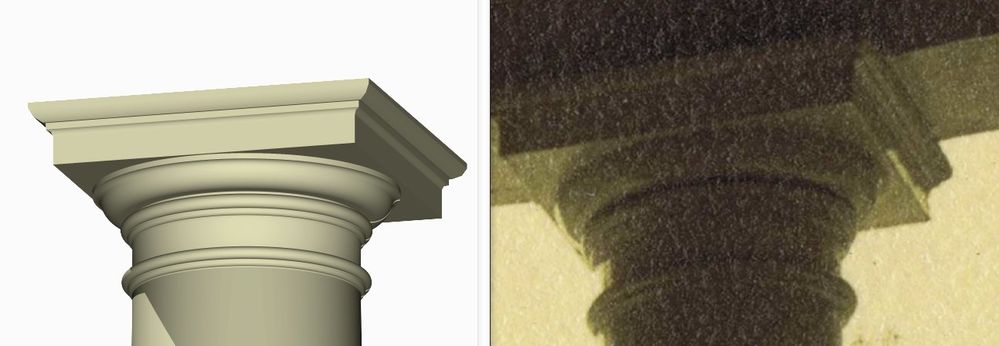

Did you create those columns (I'm guessing they're the culprit) ... or did you download them from somewhere and convert them to GDL? Tell us more about how you made them.
The base and shaft are modeled with the profiler add-on and the cap is made as a complex profile using the wall tool.
My challenge is that I HAVE to model them in extreme detail because I need to authentically reproduce historic columns. The columns need to be an exact match for the historic columns, not just sorta look like them. I work from historic photographs that I've scanned at 600-1200 dpi and I zoom way in on the detail that needs to be recreated. Then I start to create profiles and generate 3D images that match the POV and light source of the photograph. I refine the profiles over and over and over and over again until I get as close as I can get. I'll usually go through the process ~20 times for each element until I get it right.
The fabricators will use my drawings to create the milling knives to make the profiles.
Like this.
This image shows the profile for the top of the shaft and the capital. The shaft is turned on a radius in profile and the cap is made into a square with the complex profile wall tool.
Per the detail on polycount, it looks as if the shaft uses the most polygons.
Here's the detail count. Since I used the wall tool to model the base and the cap - maybe that means that the profiler add-on is creating too many polygons?
ArchiCAD users all over the world have been modeling historical buildings for decades.... but not with the precision matching that you're talking about. If an ornate capital needs to be reproduced... a craftsman will duplicate an existing one using their skills; it won't be automatically manufactured from the model.
If you're trying to drive a milling machine or 3D printer to generate absolutely smooth curves... ArchiCAD is the wrong program. There is a huge difference the 100% physical match that you're trying to do and typical construction documents - that are realistic representations at all required printing scales, or generating computer renderings that look photorealistic at all reasonable virtual camera distances (which sometimes requires making a specific element hyper-accurate, but leaving the rest 'normal').
A shop drawing instructs the mill to use certain radii and other measurements to reproduce your column. The shop drawing itself does not turn into a computer-assisted manufacturing (CAM) code sequence. Not from ArchiCAD anyway for curvy things. Timber framing, log cutting, sure. But milling rounded, decorative elements... not so much.
There is no way that today's ArchiCAD can, in the 3D window, display and manipulate a building of the detail you've described - and illustrated with the 400,000 polygons for a single column. It would be many tens or 100's of millions of polygons. Even the beefiest new Mac Pro wouldn't be able to cope. Some other 3D program might be able to do so... but I wouldn't know.
What is your final output - images, or masked images that match existing photos? Or construction documents? Or?
In this case there is no existing column and it has to be reproduced from a photograph - and the fabricator has to have an accurate construction document.
I reworked the model and converted all of the objects created in the profiler add-on to complex profile walls. This significantly reduced the # of polygons.
