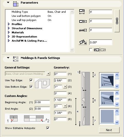

Is there a way to make the panels & moldings wall accessory tool close outside corners in addition to locating the molding so as to align with the face of the paneling properly?

Here's the settings.
Scott, have a look at this thread:
http://archicad-talk.graphisoft.com/viewtopic.php?t=6799&postdays=0&postorder=asc&highlight=moldings...
LiHigh proposes a rewritten wall accessory, that solves your corner problem.
The molding not extending to edge of can only be solved with GDL.
For the moment, you can just reduce the panel thickness (3).
There are several problems with accessories add-ons in general. They need a serious cleaning.
Thank you, I thought I was going crazy.
Per your suggestion I downloaded LiHigh's partial fix, but am not sure how to implement. The download is a RAR file type. Not sure what that is or where to stick it. Thanks, Scott
