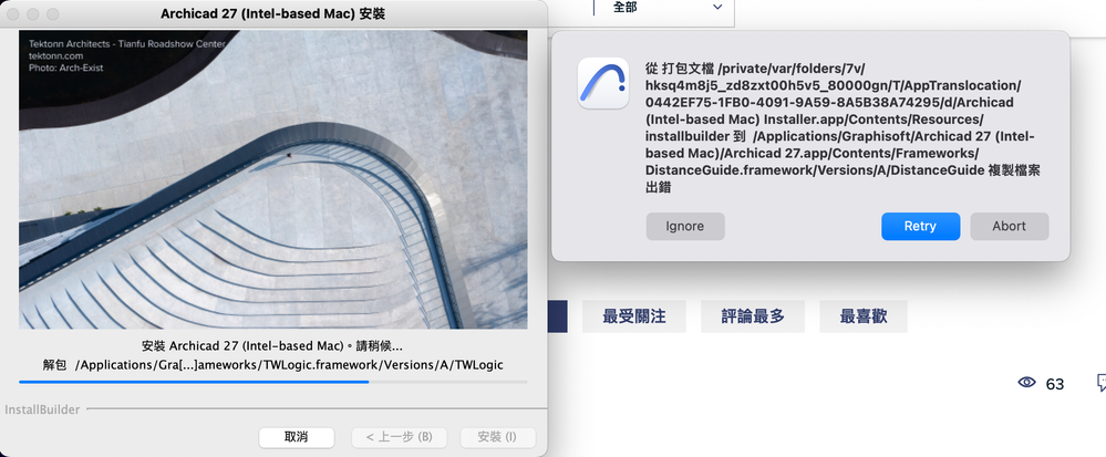

archicad 27 mac os13(intel) Installation error
Error from packaging archive to copying archive
It says: Error from packaging archive to copying archive
Retry: still Error from packaging archive to copying archive
Ignore: skipping to the next file but still Error from packaging archive to copying archive
about: Close the software
Can someone tell me what steps I'm doing wrong?

Istvan Lengyel
Installer should be started with "debug" mode:
1. Start Terminal
2. Drop the Archicad (Intel-base Mac) Installer.app/Contents/MacOS/installbuilder.sh into the Terminal Window
3. Add parameter: --debugtrace /Users/.../Downloads/debug.txt
4. Enter this line in Terminal
5. After shows the Error the Installer, send the debug.txt to the Graphisoft
