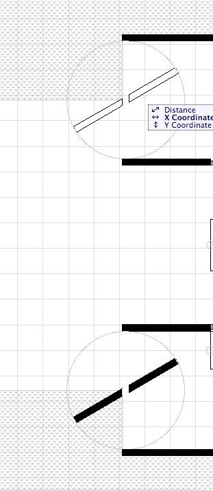

column and wall intersection help
Hi guys, I have been having trouble with my walls once I place a column in them (used to present a rotating door). The walls end up having a piece of them removed when I place the column inside them. Not just the circle part but an entire section. Even when I delete the column, the wall still has a gap in it and it has been doing this to me for nearly two years now. I have attached a photo. please let me know what you think. thanks. I LOVE ARCHICAD

Hey ArchiCAD Lover
Two years??! That's one pesky column!
Try changing the column's Intersection Priority Number in your layer dialog to something different than your wall's. Also you may want to update your layer combo(s) to keep that change permanently.
