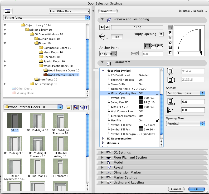

Bobby_ja_tt
hi dave
here are the screen shots
floor plan cut plane is at its default but i think u might be on to something with that idea because my model is not at the default zero level

The Model View Options look good, so you might want to check some display options for the walls, doors and windows: you should set these to "Symbolic" (this ignores the Floor Plan Cut Plane, although yours looks reasonable if your units are millimeters). For the doors go to Door Settings > Floor Plan Display > and set to "Symbolic", same location for the windows, and for the walls go to Wall Settings > Floor Plan and Section > Floor Plan Display and set to "Symbolic". If that doesn't work, then I am afraid that I am out of ideas, hopefully someone else may have a clue.

Bobby_ja_tt
hello dave
thanks for your help that last thing you suggested worked
