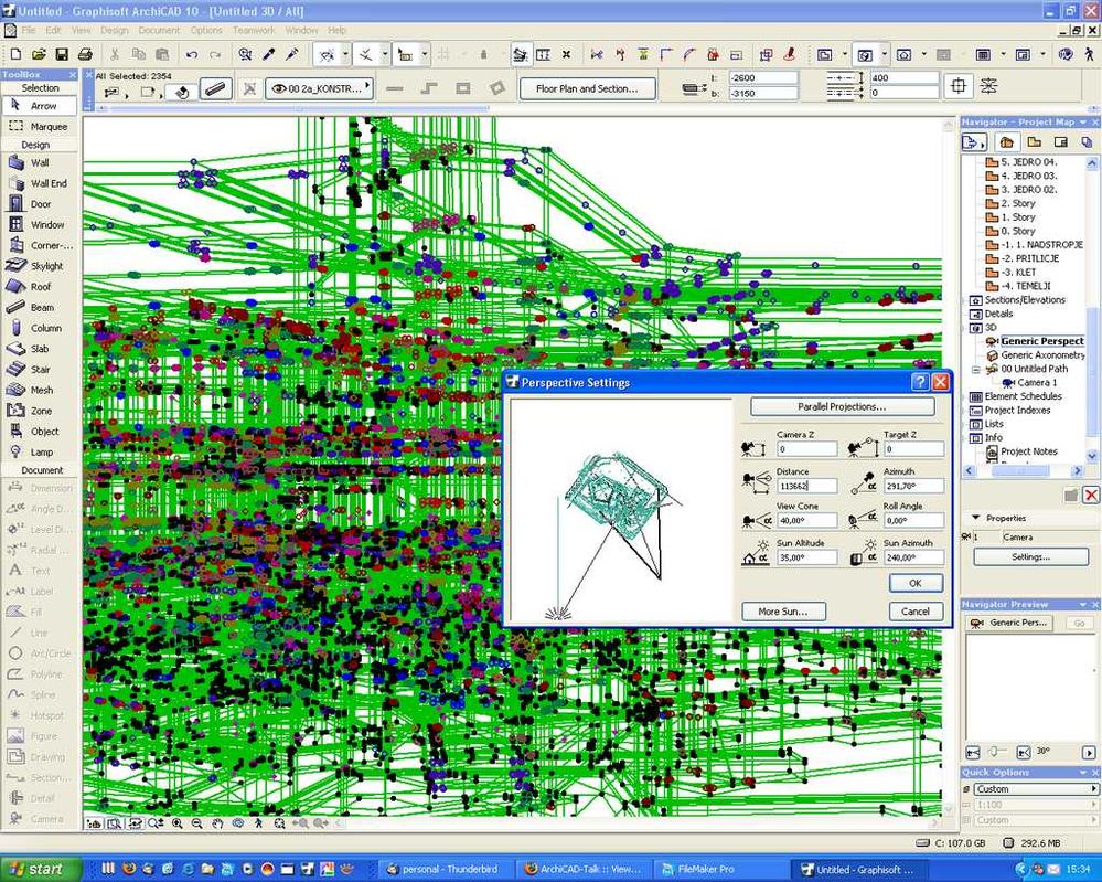

Strange, it just happened to me also. But nothing helps. I can see axonometry but no perspective. If I change the position of camera in 3D window settings I still dont see anything, but when I select all (ctrl A) I can see wireframe of all objects.
If I place a camera in floorplan I can not select it in navigator and if I select it in plan and show in 3D it jumps to Generic perspective at once. And still not seeing anything. I tried to merge or copy to a new file, but nothing helps
And here is the picture, how it looks like.

Moderator Emeritus
After opening the 3D window, just do a redraw. The thing should show.
Are you maybe running an ATI video card?

It doesn help. Not redraw, not rebuild, not changig position in 3d window settings. I have tried so many things. The thing is that I can not select any camera in navigator. As soon as I doubleclik on it it jumps to generic perspective.
It happend on our Dell precision 880 pentium 4cpu 3ghz, 1gb ram, quadro fx 1400 128mb. If I open it on my machine (and there are hw specs in my signature) it is the same. Ac 10 has all updates.
Me also having that problem.. when i want to view perspective, after i rotate and work some in perspective, then everything dissapear.. that doesn't happen in axonometric view.. i try to click fit to window but then nothings happen.. just a blank white screen.. so i have to go to my previous saved files, then open it and try to avoid beeing far or away from my building.. i think this maybe happen because of i'm not facing the building.. but how do i want to face it back.. please archicad 10, help us...
