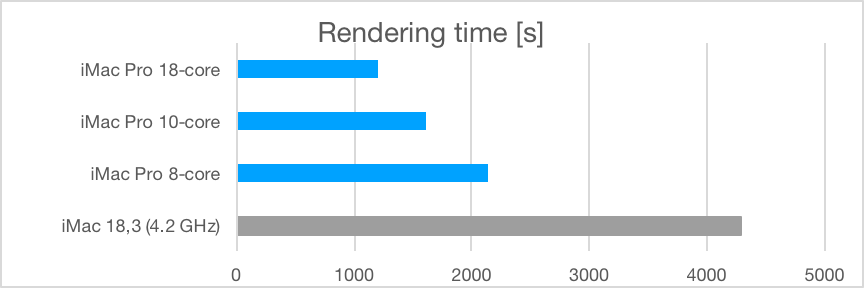

The iMac Pro comes with 4 different Intel Xeon CPU configurations: 8-cores (3.2 GHz), 10-cores (3.0 GHz), 14-cores (2.5 GHz), 18-cores (2.3 GHz). ARCHICAD uses the CPU for most operations (like Processing Elements, Generating 2D Views, Rendering). The higher number of processing cores (compared to the 4 cores of the current 5K iMac model) offers significantly higher processing power which allows faster 3D conversions and rendering, but the lower clock speed might bottleneck this performance gain in some single-core calculations. The more processing cores also allow for more efficient multitasking and background processing. Below you can see 2 examples of how the new iMac Pros stack up against the older Macs when opening 3D Views and rendering them in a big commercial project (4 146 703 polygons, 5.27 GB).
