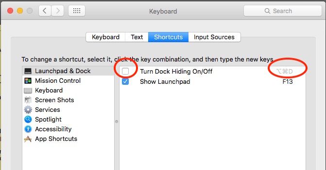

Hi everyone -
I have been away from this forum for years. I just upgraded to AC21 on Mac OSX. I am setting up my shortcuts and I have noticed AC21 will not respond to the shortcut "OPTION COMMAND D". It will not allow me to drag a copy by using the keystrokes. However, if I "right-click" over a line or object, I then can drag a copy.
I have looked in my user preferences and I noticed this IS the keystroke for drag a copy from Graphisoft out of the box. I have even tried to assign the keystroke manually and AC will not let me do it.
Interestingly "OPTION COMMAND E", rotate a copy, "OPTION COMMAND M", mirror a copy both work as intended.
Anyone else on a Mac experiencing this problem? Is this a known bug?
Thanks in advance for any insight/help offered.

Hi Robert,
Welcome back - long time!
System keyboard shortcuts take preference. You may have noticed your dock appearing and disappearing while pressing opt-cmd-D?
Go to System Preferences > Keyboard and uncheck the box for the system shortcut. It will now respond as desired within ARCHICAD.
Cheers,
Karl
rm
Karl -
As usual your reply is spot-on and solved the problem!!! Thank you for taking time to respond so quickly.
