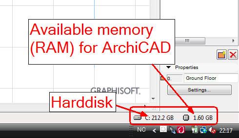

Besides from that, I agree with David Larrew. It may be a videocard problem. Is it for instance a Nvidia card, you can go to the Nvidia website and upload the latest driver.
Of course it may also be a sign of too little RAM. I have experienced similar problems when my ArchiCAD model has become to complex for my RAM. ArchiCAD goes slower and I get lines wrong in both screen and paper.
