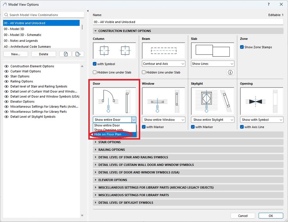

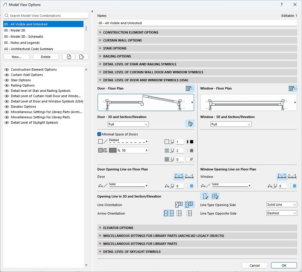

Mind if I interject?  You could go into Model View Options, under Construction Element Options and set Door and Windows to Hide in Floor Plan so that they don't show in plan view but they continue to show in 3D views.  The only problems I see with this method are, that you can't set it to individual doors and windows, its a global setting.  And two, the marker ID's get turned off as well.  The older version the markers continued to show when you set the 2D detail to Off.  In addtion, to the level of detailing, there are even more global settings available in the Detail Level of Door and Window Symbols (USA) that might help your visial presentation.  If you hadn't explored these areas, I just though it would be worth noting.
