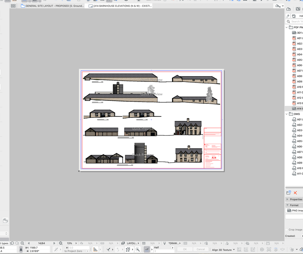

I have a Layout containing 6 Elevations, all using the 'Surface - Texture Fill, Shaded' option for Uncut and for Faded elements, like this:

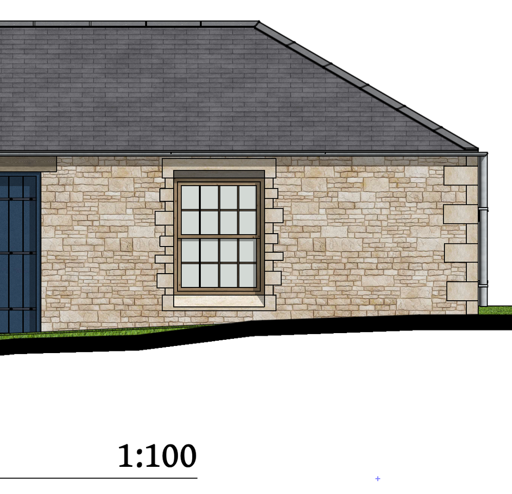

BTW, this is the level of detail in the elevations:
The Layout is meant to be A1 size (ie 841mmx594mm). But when I view the Layout at this zoom level:
and hit the Publish button, the resulting 144KB file looks like this:
Anyone knows: is this the normal behavior?
