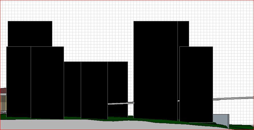

Erick wrote:Hello, which tree object is it? What is the name of the object?
Hi everyone,
I'm having problems with the 2D trees included in the library. In plan they work fine but in elevation it just appears a black box for each tree. Does anyone know why this happens?

Erick wrote:Hi again, I just had a look and none of the trees appear to work in 3D for me either in any of the options! No idea why this is happening.

Erick wrote:I see now. It isn't actually a 3D tree. It's just a 3D block with a custom image of the tree on it therefore it won't show in elevation. Very bizarre.
It's Furutrær (in norwegian), but it's the same as "pine trees" object that comes as standard in archicad
