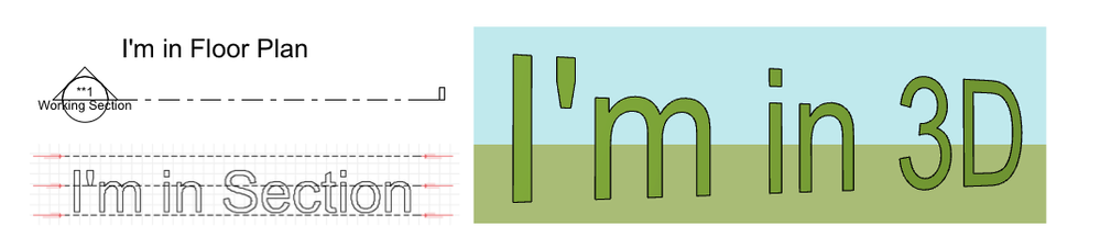

Just for the fun...
Try this 3D script, or the object uploaded
IF GLOB_CONTEXT = 3 THEN
	palabra= "I'm in 3D"
ENDIF
IF GLOB_CONTEXT = 4 THEN
palabra= "I'm in Section"
ENDIF
ROTX 90
text 1/100, 0, palabra
Try the object attached,
Look at it in Floor plan....
Section / Elevation
3D window.
It will tell which viewpoint are you using.
Enjoy!
Nando Mogollon
Director @ BuilDigital
[email protected]
... and the result...

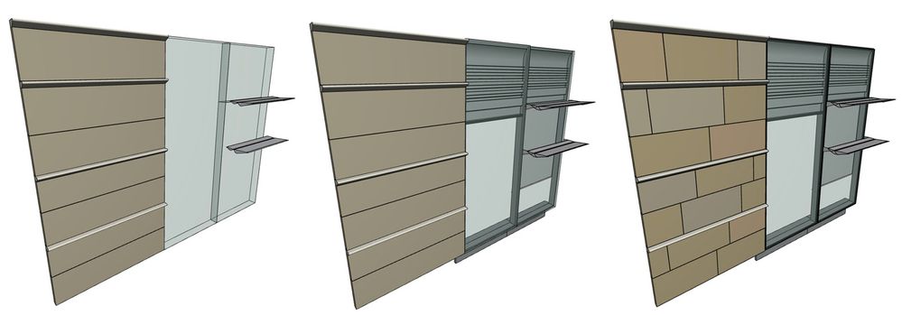

We use this LOD trick in most of our custom scripted objects now - both using the view scale to determine the object LOD to show, and also via a custom MVO setting for LOD which can be saved with different drawing types. Its actually a really powerful tool if the objects take advantage of it
Some examples of this applied to a couple of facade objects - 1:500, 1:100 and 1:20
Really helps regen times on a big project ... its actually not possible to generate an overall elevation of our 45 story tower at 1:100 or less - 'Out of Memory' error and crash : ( ... < Which is BTW why 64bit Mac is so important for all those wondering why some people think this is such a big deal
