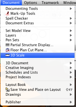

Hi Frank,
The 3D window does have it's own scale, It was introduced in AC12 with 3D documents. (see image)
I also have uploaded a simple Sphere that will react to the Context and Scale:
-Very round when in 3D window if the scale is smaller or equal to 1:50 and rough when in scales larger than that (ie 1:100)
-Very round and nice for Sections/Elevations if the scale is smaller or equal to 1:25 and rough when in larger scales.
If this principle works, Then you can control not only the RESOL of an object, but can add additional shapes or even have a different model.
We could use the Scale as a driver of the LOD [Level Of Detail] of the model.
Please let me know if yo have any trouble with the object.

Hello Frank:
Try these scripts:
! 3D Scale  :  2D Script
Text2 0, 0, Glob_Scale
! 3D Scale  :  3D Script
Text 1", 0, Glob_Scale
Then create two Views for the 3D Window, each with a different scale as shown in my earlier image. When changing views, the text will change to reflect the scale.
Or have I misunderstood the issue?
