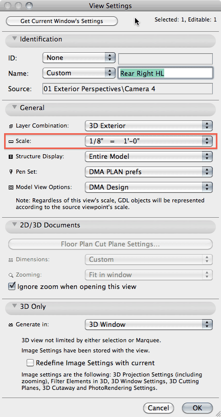

! 3D Scale : 2D Script Text2 0, 0, Glob_Scale
! 3D Scale : 3D Script Text 1", 0, Glob_ScaleThen create two Views for the 3D Window, each with a different scale as shown in my earlier image. When changing views, the text will change to reflect the scale.
