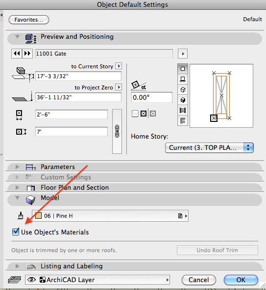

Just need to solve a problem that now i can't assign different materials to the window. I need aluminum, glass and paint 14. But I only get one single material assigned to the whole window.

Do you have this box checked when you place the object?
Yes and it still doesn´t work
Erich
Post the object and we can look at it and tell you what is going on, and potentially how to fix it.
