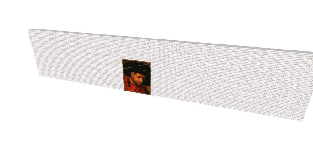

Hi Guys an Gals, greetings from Bulgaria:-)
how to change the photo in the frame of the picture object? I have tried all sorts, but AC12 keeps telling me that the picture doesn't exist.
Regards
5 Replies 5
You need to load the picture you want to use with your other loaded Libraries, and remember to type the extension in the picture name too.
Hi and thanks for the reply. I have already tried that with C:\Program Files\Graphisoft\ArchiCAD 12\ArchiCAD Library 12\[TImg] Textures 12\Pictures 12\813.jpg
Still can't get it to work.
Its a shame that Archicad just can't take the path from the project folder.
Hope to solve it soon.
Regards
If that is the location of your picture, and that library is loaded you only have to put the 813.jpg in the custom name field.

You will need to go to Library Manager and reload the library in addition to all of the above for it to show.

Ahhh gee the re-load Library thing...ahhhhhhhhhhhh.
Thanks for the reminder, all is well.
Problem Solved 🙂
