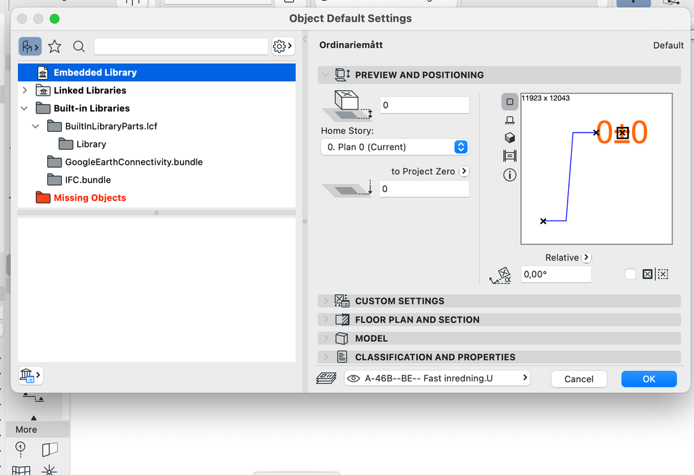

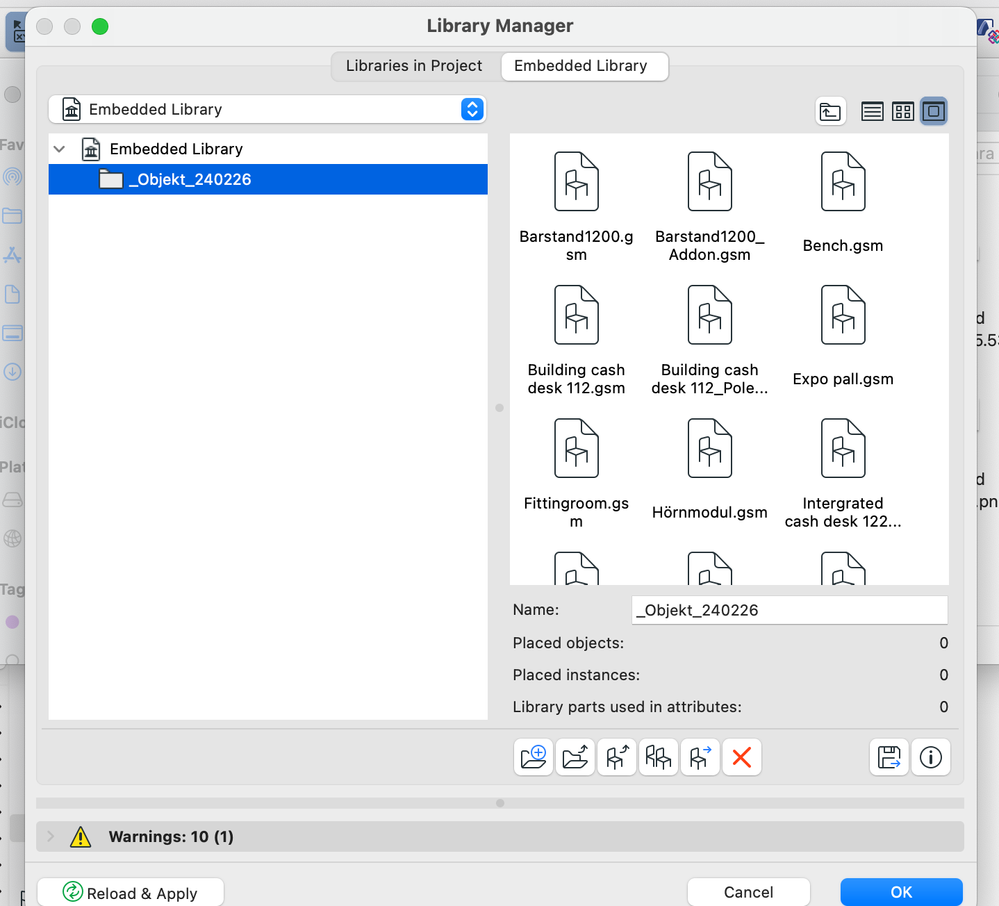

It´s not possible to open AC24 pln in AC23 (step 4). When I save AC24 pln to AC23 pln and then open it in AC23 I can see that the embedded library is there, see pic, but I can´t reach it? I have export it from AC23 but then i can´t load that folder in to AC23.......

Got it working now, had to save the AC24 in the older macOS system also, then it worked!
