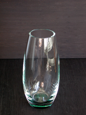

How do i make this vase using profiler???? I have tried all night and no luck.

is this the correct profile of the object?
Dwight
Better to use a fill, and always draw a section in the positive quadrant.
You know… from high school algebra where the graph to the upper right of the origin was x+, y+.
Less chance of the thing turning inside out.
I'd allow a thickness inside at the bottom that was more gracefully curved - your section looks like a cheap blown bottle rather than heavyweight crystal.
Get an expensive crystal vase and diamond cut it down the center. Scan the section. Then you'll be certain.
And be sure to increase the refraction on your glass to simulate crystal - something in the LightWorks archive on this.
