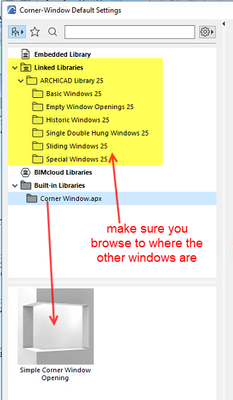

I can use my corner window tool but I can only create an empty opening for a corner window at present. I looked at the dialogue box and it shows a red folder saying, missing corner windows.
I re-loaded the AC24 library and still no corner window, only a empty opening symbol.

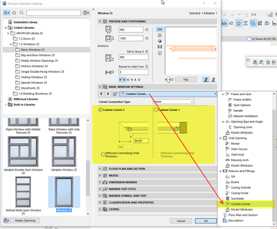

The corner window tool should just use the regular windows, but with the corner window tool, I believe that both sides of the corner have to be the same window configuration (maybe not the same width).
It will only show as a regular window in the settings, you will not see the corner configuration.
However you can just use a standard window and turn on the custom corner and then move it to the corner of the walls.
This way you can configure each window differently.
i.e. fixed on one wall and sliding or awning on the other wall.
You will have much better control with separate windows, especially if you want them to be different.

But you have all the other standard windows?
Win11 | i9 10850K | 64GB | RX6600 Win11 | i9 11900K | 32GB | GTX2080TI
Make sure you browse to the main library where all the other windows are.

Yes, I did browse to my other windows in AC24 and they are there.
I am installing AC20,21 &22 at present. That I haven’t done before.
I got a red folder before saying corner windows are missing.
I will take a screen shot to show you the red folder.
